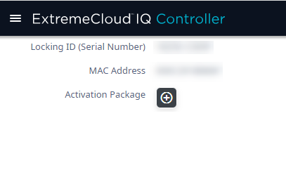

  1. To obtain the controller Locking ID:
    1. Log in to ExtremeCloud IQ Controller.
    2. Go to Administration > License > License Details.
      The Locking ID is the controller Serial Number.

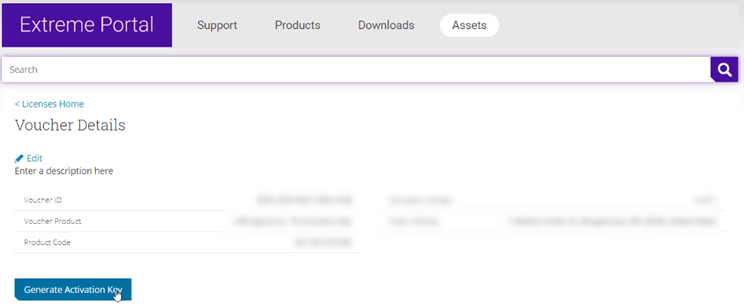

  2. Log into the Extreme Networks Support Portal.
  3. Go to Assets > Licenses Home and select the ExtremeCloud IQ Controller Voucher ID line item from the list.
  4. On the Voucher Details page, select Generate Activation Key.
  5. Provide the Locking ID for the ExtremeCloud IQ Controller to be activated.
  6. Check the box to accept Terms and Conditions and select Submit.
  7. The Activation Package is generated.
    The Save As dialog displays.

Stage your ExtremeCloud IQ Controller instance. Install the Activation Package to activate ExtremeCloud IQ Controller:
  1. Return to the ExtremeCloud IQ Controller instance from where you obtained the Locking ID.
  3. Select the plus sign next to the Activation Package field.
    Installing New Activation Package
    Controller Licensed Details — New Activation Package
  4. Drag the Activation Package to the Upload License dialog to install the Activation Package.
  5. Refresh the browser after installing the Activation Package.
